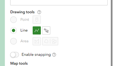

I have a survey123 survey with a line geotrace. When i put it in the survey widget in experience builder there is no geotrace option, just the vertex option. Is it possible to do?
Thank you
Kim

Hi @kimkjohnson ,
The survey added to the Experience Builder survey widget still follows the survey settings. If you need the vertex option, you may need to republish your survey with the vertex option selected.
