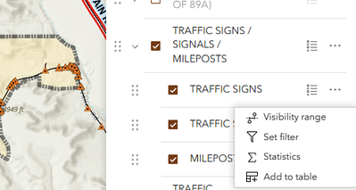

Is this a setting in MapViewer I need to configure? See below screenshots:
Logged in:
Logged InLogged In
Logged out:
Logged OutLogged Out
They can interface with the data in every other way. The option to export is simply missing, and only in Experience Builder. The webapps built in web app builder using these same map image layers/feature services work fine.

They are interfacing with these applications while "logged out". They do not have roles.
They are able to export data from our web applications, but not our web experiences.
There shouldn't be a difference in the behavior of data exporting of identical feature services between Experiences and WAb applications.
See attached screenshots for the missing export option in the Web Experience, but the option is available in the Web Application:
