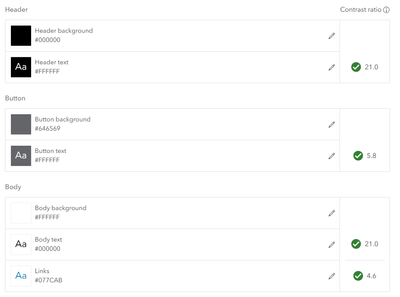

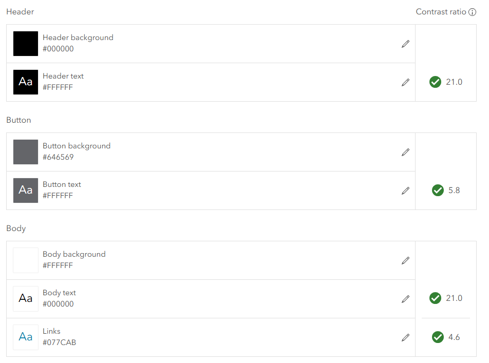

I'm trying to use Shared Theme to apply our org's Brand Guideline colors to all of our apps.
For older apps the Shared Theme controls are working as expected: I can directly set the header colors, buttons, and body text.  It doesn't really fit our palette well, but I can use the grayscale colors fine.

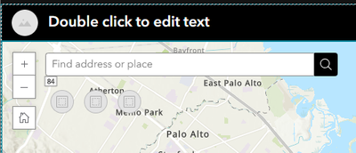

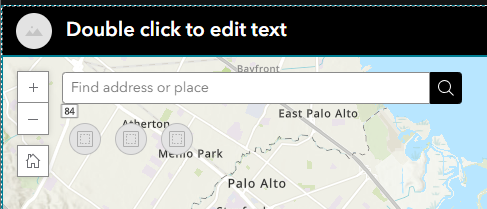

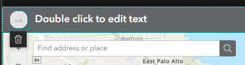

For Experience Builder, the "Organization Theme" doesn't match any of this, instead defaulting to a different mid-grey for Header Color and completely ignoring the Shared Theme Logo.

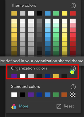

Experience Builder theme is much more complex and has more color variables then shared theme does. So we can only try our best to match the colors in your shared theme to ExB. The "Button background" color in your shared theme will be picked to be "Primary" color in ExB, and the "Button text" color will match the "Dark" color in ExB. The "Body background" will match the Secondary color in ExB.
There is no way to match perfectly for different theme system. But you can manually adjust the app design to use the colors from your org shared theme. In color picker of EXB, you can see these colors from org. So you can decide where to use what color to match your shared theme.

@Wei_Ying What is the difference between the "Organization Shared" theme at the top
and the "Shared theme" at the bottom?
Wei_Ying
@AndreaB_ Good question!. You are opening an old app in new version after we upgraded theme system.
The old theme you used will always listed under "Your current theme" after the upgrade.
The top theme "Organization shared" is the old theme mapping from organization setting. And the bottom one is the new theme mapping from organization setting. They are both organization theme, but the bottom one is improved for theme variable mapping.
