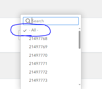

Thanks @SumingSun , I managed to get it to work and query my datasource. Is there any way to remove the "All" option in the dropdown? I only need to select one option and never more than one.

Hello @SerjStol, the Tag '- All -' can't be removed when prop isMultiple=false. It's the only way to remove the current selected value for users. You can custom the label with prop allTag: string if needed.

@SumingSun Thats a shame it cant be removed as it seems counter intuitive since i set prop isMultiple={false} then why would I want to select "All". I tried to add allTag="Please select one site..." but it still shows as "-All-". Am I doing it wrong?

vijaybadugu
use
isEmptyOptionHidden={true} to hide -All- option
