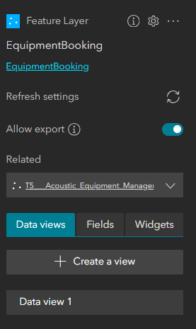

Not sure if I'm missing something here but how do you use a view as the action data? Firstly, I'm assuming it's referring to views created within the experience builder app rather than views generated in AGOL as separate layers. As you can see below my layer has a view called Data view 1 but this is not available to select when selecting your action data. Is there any way to set actions against views as the help suggests? This would be very useful to me as the alternative is to have separate views in AGOL or in my map which just makes things slightly trickier to work with across multiple widgets.

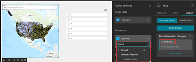

You could select views of Action data here.

AnthonyJonesRSK
Thanks for the quick response on this Ke, I'm obviously not up to speed after the Christmas break as completely missed that! Thanks for your help. Anthony
