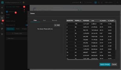

Hi @Mike_RPC
In ArcGIS Experience Builder, after adding a data source, you can set it to display only data from a specific category.
Then, you can add the same web map again and set it to display data from other categories. Show different categories of web maps on different pages.
Thanks,
Ke
