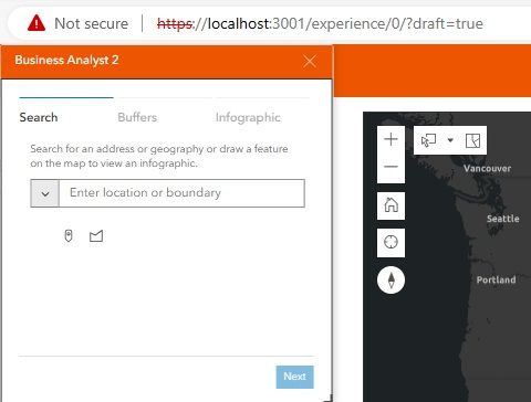

Something happened with the Business Analyst widget when I deploy it. When I'm looking from the preview option looks great.

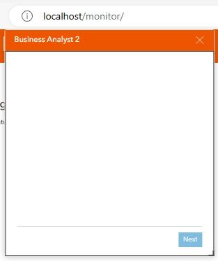

But when I save the project, extract the files and copy to my wwwroot folder just remain in blank
It was working fine until around 1 - 2 weeks ago.
Thanks.

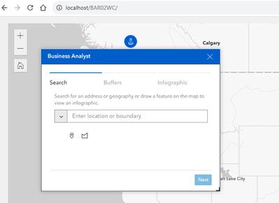

Sorry about that @Hanoit We are looking into this as we are able to reproduce the issue with the latest release. However, I tested the previous developer edition that you showed above in your screen shot and confirmed the app loads fine when deployed:
So I suspect there must be something else you might be missing in your deployment. Can you please confirm that you followed these steps to deploy your app? https://developers.arcgis.com/experience-builder/guide/deployment-topics/

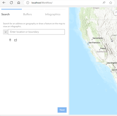

FasilTiru
Hi @Hanoit
Please follow these instructions to download and deploy the patch for the latest version that fixes the loading issue.
A Business Analyst widget patch is available for Experience Builder Developer Edition (Version 1.13)
The workflow mode should load now if deployed properly to your web server as follows:

Hanoit
Thanks, It's working now.
