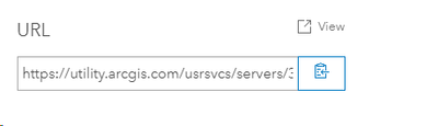

2. From the settings page of the layer, copy the URL of the layer you want to share.

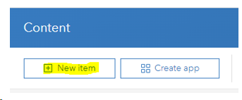

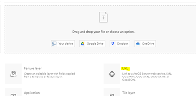

3. Add it back in to ArcGIS Online as a new item.

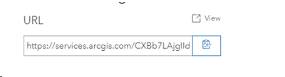

4. Paste in the copied URL and select the option to not prompt for authentication.

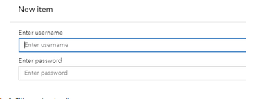

5. Enter the username and password to use to access the data (user should be able to access, suggest using a service account).

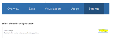

7. Once the layer has been loaded, go to the settings section and click the Limit Usage Button.

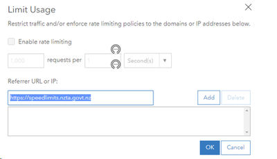

8. Add in the URL to the application that will be using the data. (this would be the URL of your Experience. I would then also share this (at this level, eg within the layer) to your curated group). My thinking is that if you tried to shared this via the actual group, AGOL would not be able access, and if you add in AGOL as an allowed refer, then it breaks the whole point of the operation.
