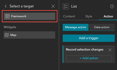

I'm working with Experience Builder developer edition and have two list widgets  Widget one has states and widget two has counties.   Both lists data are derived from corresponding map layers.   If I select a state is List #1, I'm trying to filter the available entries in List #2.   I have the action setup to filter the map layers, which works just fine, but the values in List #2 never change.   It continues to show the complete county list for the nation.

Hi @PaulNRWA .
For your case, the filter action should be set on the framework, not the map widget.

PaulNRWA
Thanks Shengdi.  That indeed was the solution.
