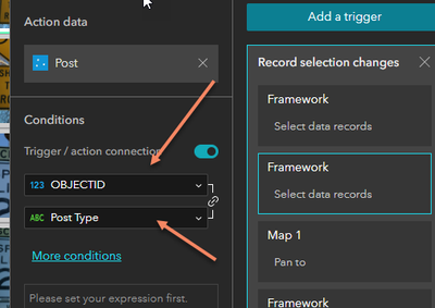

Not sure if this applies, or whethere there is the ability to code an action for them, but if so, I have found one way to "un-select" all in a layer.
Basically, I pass a Select data records action, but, in the conditions, I set two fields that will NEVER be equal.
So,
In this case, when the action fires, all selections in the Post dataset are removed (as OBJECTID will never = PostType).
Anyway, don't know if it will help you, but this is how I have handled "un-selecting" all on an action.

CraigUtter
Hi R,
I'm not sure if that will work because I would have to put in the same trigger/action settings as the one that actually selects the data in the framework. I will look into this suggestion though, because it's intriguing.
RhettZufelt
MVP Notable Contributor
Wasn't sure if it would help, but threw it out there.
Looking further, not what you need anyway as your selection is getting cleared, and that is what is causing the issue with the attributes names showing in the window.  The info window you have loading shows data for  the selected feature, when you click the popup off, the selection goes away.
See my post in your other thread about this for info on the empty selection thing.
