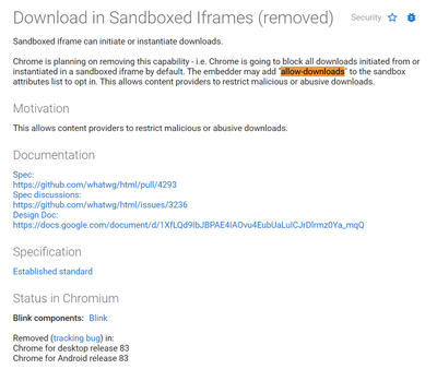

This behavior is related to recent browser updates, removing the allow-downloads flag for the sandboxed iframe:
Chrome has removed it since v83:
FF has removed it since v82 (recently):
We are looking into it and see what we can do, especially for .arcgis domains. In the meantime, to make it work you might need to keep using the old versions of these browsers.

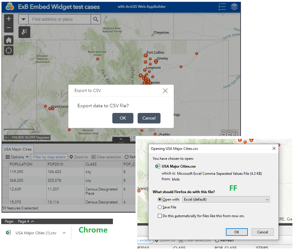

I did a quick test in the AGOL environment (ExB v9.1) and I can export CSV from my Web AppBuilder app successfully, in both Chrome (v90.0.4430.93) and FF (v88.0) browser:
Could you help provide any steps or environments to reproduce what your users are seeing? That could be helpful.
