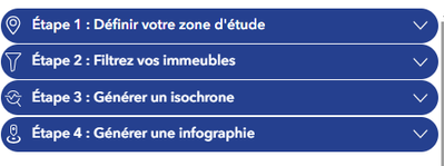

Hi guys, I want to use the accordion widget to create a step-by-step methodology for my users.
The methodology is simple :
Step 1 : they define they're study zone : it's 2 filter, by country or by market zone
Step 2 : they can use 10 differents filter to keep a typical profil of a building
Step 3 : Using the analysis widget to generate a travel time area (for example 15 minutes by driving) on the remaining features (remaining buildings)
Step 4 : Generate an infography by Business Analyst

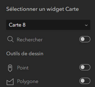

To make this more beautiful, I set the BA Widget to hide the search function, so i disable all parameters :
And i disable the area zone parameter :

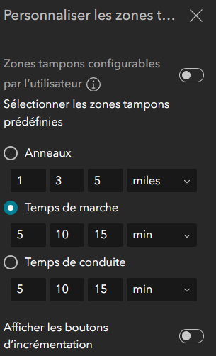

But as you can see on the screenshot, i'm forced to choice one of the three method (here the walking time).
So, if I launch my app, make the methodology step by step, and when my travel time area (created by the step 3) is ended, I can choice my new area and make my infography without any problem (and the BA widget ask the user only to generatethe infography, i have not the two other useless step [for my case])
BUT, if my user want to navigate on the map before, click on the building on the map to see the pop-up box, when he click on one of the building, the BA widget create automatically a walking time zone of 5/10/15 minutes around the building that the user clicking on.
It seems to be impossible to disable the automated creation of a default zone. OR i miss something ? and if it's not possible actually, can it be possible in the future please ?

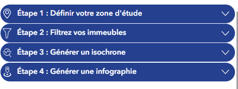

My end user have the needs to see the map for each step that I present in my screenshot.
My map is on 80% of the app, and the accordion widget is 20% on the left.
