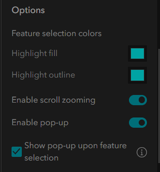

I would like to trigger pop-ups to open when features are selected interactively from the map's 'Select' tool.
The Builder provides the option to 'Show pop-up upon feature selection', but as the more info button states: a "Selection made interactively from the map is excluded".

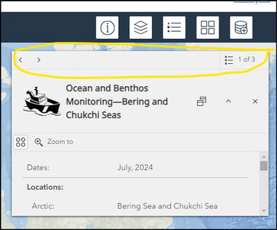

The pagination action bar appears on top of the pop-up window when there are multiple records clicked on the map, allowing the user to identify the number of records within the click radius and cycle through each feature's pop-up details.
There is also a fair bit of pop-up styling via custom HTML so I'm not sure the Feature widget would work for this application, but I'll look into this example! Thanks so much.
