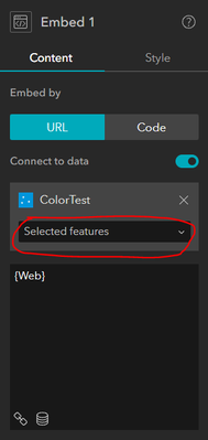

Hi @elpinguino ,
I suppose the Embed widget can do this.
Connect the Embed widget to the data, choose the selected features view, and add an attribute containing the URL linked to the PDF or S123 report.
