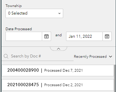

Hi,
I have a list widget that uses the filter tool.
I'm hoping for the following behaviour: when the user filters the list with the filter tool, the map zooms to the extent of the items found in the (filtered) list.
Is this possible with the list widget, or would this require customization?
Thanks,
Ron

RonaldFraboni
So use a filter widget on the list instead of the filter tool that is available within the list widget.
Thanks, Josh.
