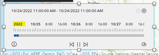

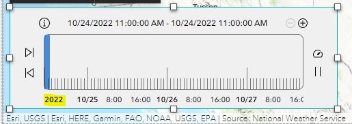

I am using the Timeline widget in Exb and for some reason it starts with a 4-digit year, the other dates in the widget are formatted as month/day.  How do I adjust the first date to be in a Month/day format?

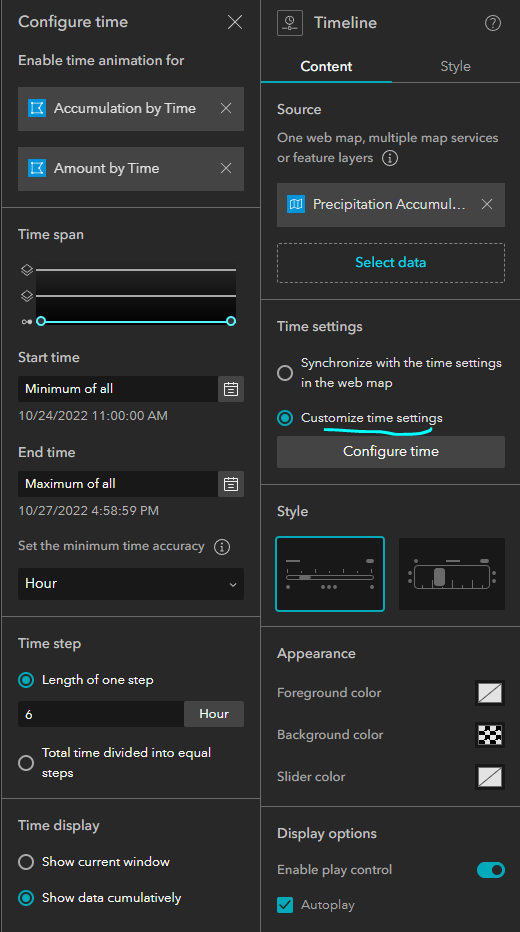

The 4-digit year appears in both style options in Exb
I am using the "Customize time setting"
The base map is using a Living Atlas layer: National Weather Service Precipitation Forecast
https://sandiego.maps.arcgis.com/home/item.html?id=f9e9283b9c9741d09aad633f68758bf6

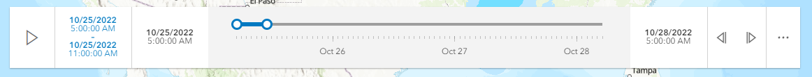

The time slider in the map does not start off with a 4-digit year

The new option "Display accuracy" added in the recent AGOL release can allow you to define the level of info you'd like to display now:
11 Replies
TonghuiMing
Hi @RyanBohan - we have not yet provided the custom time format settings, so unfortunately that's the behavior for now. We will take your case into consideration for further evaluation. Thanks for bringing this up and keep tuned.

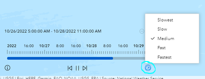

Also is there a way to set the default speed in Exb?
In the map I set the play rate set to "Fast"
In Exb it is changed to Medium.  How do I change the default speed to "Fastest"?
TonghuiMing
Hi @RyanBohan,
The current logic for Timeline is that, if you honor the Map viewer time settings, the speed will be inherited from the Map; if you go with the Custom time settings, the default speed at runtime will be "Medium" - basically what you have seen.

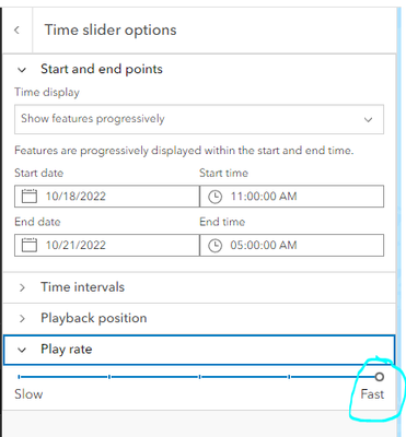

Hi @RyanBohan - as for the speed settings, it has been enhanced in the recent AGOL 2023 June release. You can give it a try.
In the custom mode:
- If in a previously-configured app with custom mode, the default speed will be set as 'Medium'
- If using a feature layer or map service layer directly, the default speed will be 'Medium'
- If using a web map as the data source in newly-created apps, the default speed will honor what has been configured inside the MV
RyanBohan
Hi @TonghuiMing,
Yes, I was able to Configure the time settings to default to Fast.
Thank you.

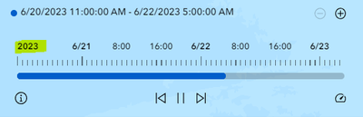

Is there any way to remove the year from the start of the timeline?  I am only showing a sliding 3-day window, so no need to show the year.  Either having the start date/time, or simply today would be more appropriate.
Thank you
TonghuiMing
I believe that's our current design in case users might not know which year they are at. This would be considered together with our labeling enhancement evaluations.
RyanBohan
Hi @TonghuiMing,
Thank you for the information.

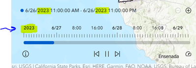

Currently Experience Builder labels the year in 3 locations.
Please consider removing the 3rd label for year.  Keeping it Month/Day.  It seems 2023 would be best to represent a new year only, the first section of the Timeline slider (below) does not represent 6 months.
Thank you
