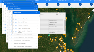

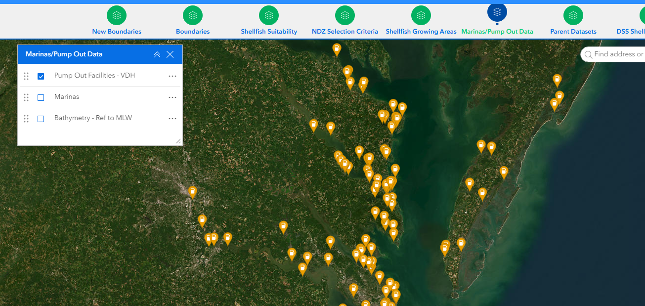

In Experience Builder, I have multiple Map Layer widgets inside of a widget controller. I have LOTS of layers on my map, so separating layers into categories separated out into each map layer widget allows the user to quickly view the available categories to identify where to find the layer they need.  It works great for organizing all of the data layers available on the map.  The issue is when a feature on the map is selected (some layers have additional popup information), all of the map layer popups popup...except two.  Two do not. This is what I want. I only want the map layer list(s) visible that the user has chosen. I don't want all of the map layer lists to popup every time there is a feature selected. It takes up space on the screen and then the user has to close these every time.  I can't see any difference in property settings for the map layer widgets that don't pop up when a feature is selected and those that do. Does anyone know how I can prevent the maplayer lists from popping up if a feature is selected?
Image 1: User opened the Marinas/PumpOut Map Layer List.  The map layer list pops up.
Image 2: When the user selects a feature, all of the map layer lists in the widget controller popup (except 2).

Hi - This problem is solved. I had a Trigger set on the Map Widget that was causing this. I deleted it and the map layers no longer popup!!!
