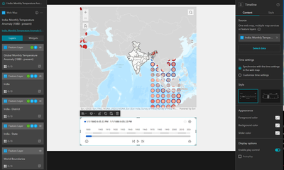

@kmsmikrud I tried to search a living atlas layer with the keyword 'Sea Surface Temperature', and it does work:
Not sure what happened in your case. Care to share the problematic data here? Thanks.
