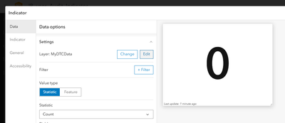

StuartMoore
we have a similar use case and use an imbedded dashboard element
that only shows the number based on the current users audit failures
this is the dashboard bit
// Write an expression that returns a FeatureSet.
// Documentation: https://arcg.is/3c419TD
// Samples: https://arcg.is/HPbi00
var features = FeatureSetByPortalItem( Portal('https://www.arcgis.com'), '3e9...790d', 1, ['*'], false);
var currentusr = GetUser().username;
var filterwhere = "Audit_Status in ('In Progress') and Survey_by = '"+currentusr+"'" //'Open','In Progress','Query'
var result = Filter(features, filterwhere);
return result;
i set the dashboard to refresh every 15 minutes or so
see if that fits the bill
Stu

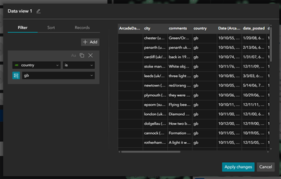

Could you set up Data Views to handle the SQL part of the problem? I don't think this should significantly impact performance.
You should be able to use Count on the OBJECTIDs to find the total number of records in the filtered dataset.

DarraghOSullivan
Thanks @JeffreyThompson2 ,
Yes I might do that but was trying to avoid views with thousands of features if possible for something that seems quite simple! If setting up views, is it more efficient to set them up within ExB or externally, where I can reduce the fields etc?
