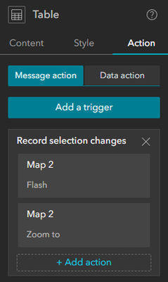

In EB with the table widget, if a user selects a record and there is a message action set up to select and zoom to the corresponding record on the map, but the layer is turned off, is there a way to force the layer to turn on, or perhaps flash the feature?

You can try the action Record Selection Changes - Map - Flash.
Let me know if that helps or if you have any other questions.

@ShengdiZhang Thanks, flash works.  Is there a way to turn the layer on if it is off?
ShengdiZhang
Unfortunately, there is no way to turn the layer on for now.
