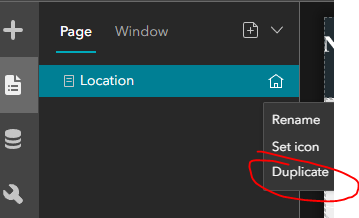

I have an EB builder app in AGO where I'd like to create duplicates of the page, but when I click "Duplicate" nothing seems to happen.  I click the three dots to the right of the page name, and then click Duplicate.  Any ideas why this might not be working?
If I create a new EB app and click Duplicate it is then successful.

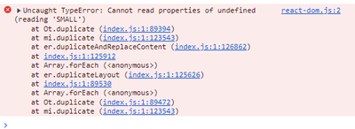

Hi @ShengdiZhang , I've submitted a support request and will update with any findings.  Just for more information, I am seeing this in the developer tools console in Chrome when I click the Duplicate option:
Looking at the json for this app in ArcGIS Assistant, I assume "SMALL" is the name of the layout for small mobile device screens.
