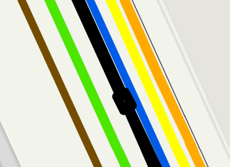

Short story: symbols that work in Pro 3.3, Map Viewer and Instant Apps are not rendering correctly in Experience Builder.
I have created custom line symbols that are dashed with 1 or 2 characters indicating which utility they represent. It’s important that the characters are not overlapped by lines for readability, so I have configured the dashes and character spacing and repeats.
This is how it looks in Pro, in a Web Map Viewer, and in an Instant App (perfect, no issues):
And this is how it looks in EB – spacing all off:
I have opened a fresh new Experience Builder and a fresh new Map Viewer with only this layer to ensure I haven’t set some kind of symbol rendering, and it’s always the same. EB just won’t honour the symbology at any zoom level from either the web style or ArcGIS Pro. I thought this was an issue going the other way – that Web App Builder would be the issue, so I’m not able to find any help docs on this.

Downgraded symbols are not the solution:
The first two publishing attempts listed above result in the exact same outcome (it works everywhere except EB). Is this a known issue? I thought building my app in EB would save me issues like this, but it seems like if I want my users to have the right symbols, I will need to convert it to an instant app.
