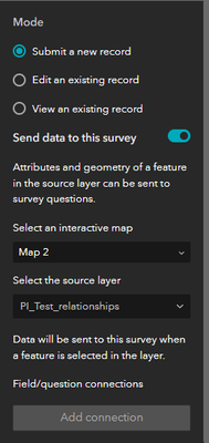

Hello, I created a survey from an existing feature service using Survey123 Connect. I would like to send data to the survey however, I am not given the option because the Add Connection button is greyed out. I am given the option to Add Connections if I connect to a different map widget and layers within the app. Am I missing a setting or action somewhere else within the app?

After submitting this post, I quickly realized it was because my layers were grouped. After I ungrouped them in my web map and refreshed experience builder, everything worked as expected.

Thank you for answering your own question and posting it here.  It helped us fix the same issue we were having in our Experience Builder.
