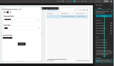

Good afternoon,
I added a Survey123 widget to my EN application. referenced a survery123 created with Connect and now I am getting the following error message:
Editing is not possible because the record specified by the globalId parameter cannot be accessed
Ruth_JiatengXu
Hi @SanchezNuñez ,
Thanks for sharing. When using the "Edit an existing record" mode in the Survey widget, the source layer needs to be the one where the survey record will be submitted.
Could you please check if the source layer you selected is correct? If it is, could you please provide more information to help us identify the issue.
Thanks,
Ruth
