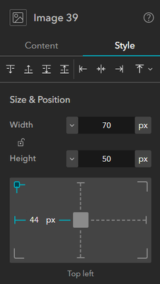

DougLogsdon2
Under the Style tab, Size & Position section, change the unit from % to px:

DougLogsdon2
The header text will need to be set as pixel as well. Otherwise, it will change position based on the browser width, too.
