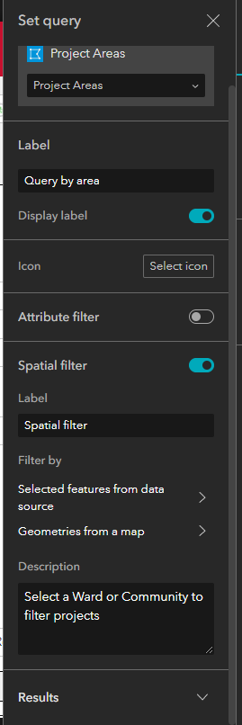

I am configuring an EB app and I want to do a spatial filter query.
Here is my configuration.

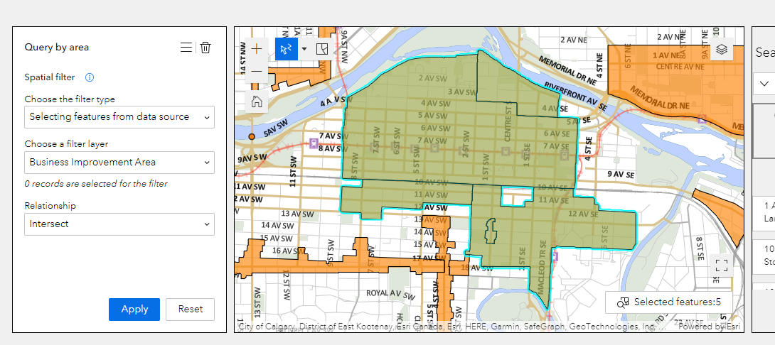

But when I use the select tool in the Map the selected records are not passed to the query widget. In the image below you can see that 5 areas are selected but none are indicated on the query widget.
If I make the selection again or change the filter layer to something else and then back again the selection is passed to the widget. I would like this to be passed first time to eliminate the confusing workflow.
Any advice?
TonghuiMing
@RossFindlayCOC This issue should be solved with today's AGOL 10.2 release. Please give it another try, thanks.

TonghuiMing
@RossFindlayCOC I can reproduce your described issue and it does look weird. We will take a look at it.
TonghuiMing
RossFindlayCOC
Affirmative, thanks to your team for such a quick turn around to apply a fix.
