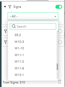

Is there a way to change the sort order in the filter widget, especially to Natural Sort?
I have set up an expression using the unique values option.  Nice as it gives me the list of values to filter on, but they are sorted alphabetically, and I need a natural sort option.
Really confusing the the user when things are way farther down the list than expecting.
W1 and W2 should come before 10, and so on.
Looks like thisWant to look like this
W10-1W1-1
W11-1W2-4
W1-1W10-1
W2-4W11-1

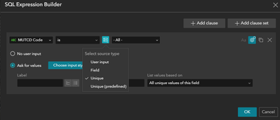

@TonghuiMing There is a domain on the field, and my filter query looks like:
So it only pulls values that are currently populated in the data.

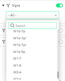

It appears as if the filter widget is still sorting like the previous version:

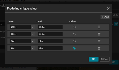

I'm running into these issues as well, but using Predefined Unique Values. I need to be able to sort the predefined values filter smallest to largest, but keep different nomenclature. See below. I can drag the predefined values to my desired order, but it does not affect the way the filter is sorting in the app. It seems that it defaults the sorting based on the Label. As a workaround, I can change the labels to get an order I need, but it's not very clean and it would be easier if the order I specify when I'm defining the values was used in the app.
