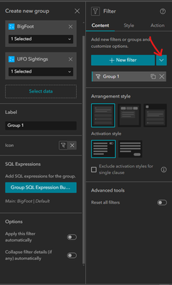

Experience Builder allows for adding multiple Map Widgets to a project. If you are on the most recent versions, you can create a Group Filter that allows for filtering multiple layers at once, including across multiple maps. Add a Filter Widget and use the carrot next to the New Filter Button to add a Group Filter.

Did you set the fields in Group Filter?
