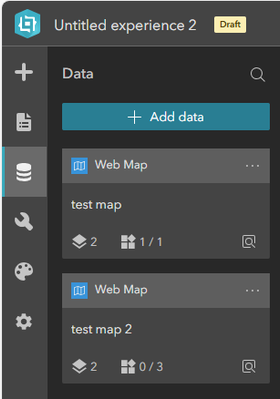

For example, I've added the ACS Population layer and the USA Current Wildfires layer from Living Atlas to a map. In Experience Builder, I've gone to "Add Data" and added the map twice.
In a map widget, I've added one instance of the data. For a list widget and a chart widget, I've added data from the other instance (I have the chart widget pointed to the selected features data view though, so it's blank until a selection is made because I haven't set up the no-selected-features view). I then set an action on the list (trigger is data instance 2) to zoom to the same feature in the map (action data is instance 1) based on the objectID.
