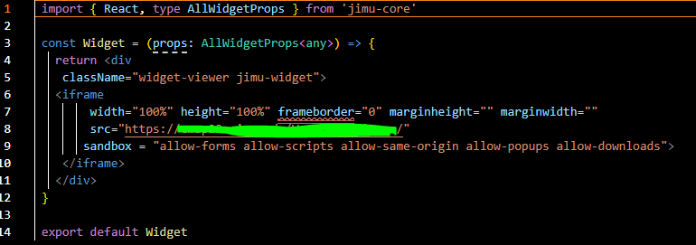

CatherineRD
Thankyou, that worked! Although I hard coded the source filename in the widget.tsx, I would prefer to do it through the tool. I imagine I can, I jut haven't worked with custom widgets before. But this gets me a solution until I can look at that.

CatherineRD
Zhujing,
This is the code from the widget.tsx file, the src is the external app that I have in my experience builder web page. This custom widget bypasses the sandbox limitation and the app now works as it should (the print functionality). I'm not sure that is your question - I do not export attribute info. The custom widget replaces the embed widget I was using because I needed to allow the app print functionality to work.
