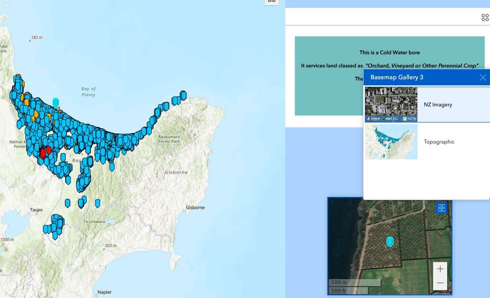

On the Water Bore page I'm working on, I want to be able to select a bore location from the main map widget and on an inset map widget, automatically zoom to that bore location overlaid onto an aerial basemap.
Both maps widgets contain the same Map data, which has an NZ topographic basemap.
Everything is working as I want it  - except that I can't set the inset map widget to default to the aerial basemap  - it defaults to NZ topographic and I have to select aerial basemap with a basemap widget.
Is it possible to select a different default basemap for the same map in different map widgets?
Some clarification - I'd like the user to be able to do what they like with the big map (zoom in and out, choose their own basemap etc.) - but when they select a specific bore - I'd like them to immediately see a zoomed-in aerial view of the bore.

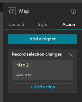

If I were to have a Map 'A' (Topo Basemap ) in widget '1' and a Map 'B' (Aerial Basemap) in widget '2' is it possible to select an object in Map A and zoom to the object (or a duplicate with the same UID) in Map B?
AndreasHall
Yes it is possible. the configuration should look something like this:
