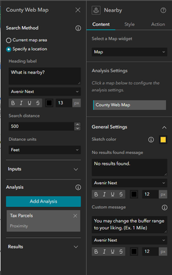

@DarraghOSullivan I have notice this myself. I use the near me widget instead.
DarraghOSullivan
Thanks @JudithWammack , I've tried the Near Me but I do need the Select Widget unfortunately.
JudithWammack
@DarraghOSullivan, I use both as well. You can make the Select widget actions interact with the Near Me widget.
Nearby Setup:
Select Actions:
