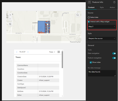

Hi @JayHodny,
It is recommended to use a Feature Info widget, where the Feature Info is connected to the Map. This way, when clicking on features from different layers, the Feature Info layer will automatically switch, avoiding confusion for users.
Thanks,
Ke
