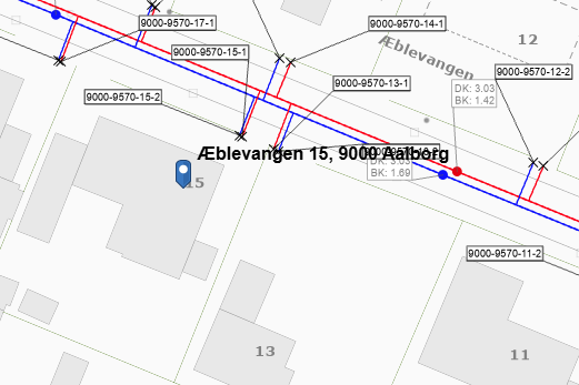

In WebApp Builder it is possible to display a Pin Marker  and display an associated text, by entering a coordinate set and writing a text as URL parameters. For example:
........maps.arcgis.com/apps/webappviewer/index.html?id=26fb9389f6544f7d9400024adcd4d95c&marker=552412.3201512357;6321447.4502395615;25832;;;%C3%86blevangen%2015,%209000%20Aalborg&level=12
I can't find a similar function for Experience Builder. Does anyone know how to do that?
Any help would be appreciated - thanks 🙂
Pin Marker with textPin Marker with text
