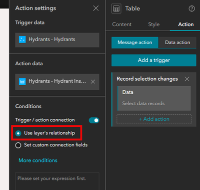

Hi @JasperRomero ,
When selecting records on a layer, you can also select or filter the related records using the message action  Record Selection Changes > Data > Select/Filter Data Records, and choose "Use layer's relationship" for the action conditions.
To export the report to CSV, add a table widget that displays only the selected records of the related layer. Then, use the Data Action button to export.

Hi @JasperRomero ,

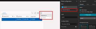

Hi @ShengdiZhang , thanks for the helpful response! I wound up implementing something similar to what you are describing, so it's helpful to hear that this is essentially the right approach. For the table that displays selected records - is there any way to format the table so it only ever displays selected records (i.e. is empty until a selection is made)? Or will I need to toggle the "show selected" button each time the selection is made? Works fine either way, just wondering if it is possible to streamline/remove steps. Thank you!
ShengdiZhang
Hi, when configuring the table widget, you can select the "selected features view".
