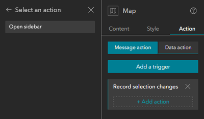

2. For testing purposes I've eliminated all elements besides the Map, the Layer List, and the Custom Filter Widget, but I don't have the option to set my Custom Filter Widget as an action item connected to the Map:
3. As far as I can tell, all possible settings that would trigger anything at all have been disabled, I don't think there's any triggerable actions within the Experience Builder anymore but this behavior persists.
