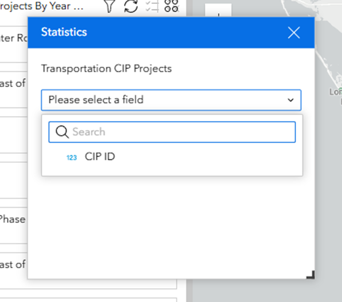

Hello - is there a trick to getting the data action for 'Statistics' to show all of my numeric fields as selectable in the List Widget for ArcGIS Online?
I have Cost attributes as Long Integers but the only one that shows is this CIP ID field.
I do get choices in the Table Widget for all of my numeric fields.

The fields showed in statistics comes from the fields used in the list widget for both performance and functional considerations -- if a field is not showed in the widget, it should not show in its statistics too.

I thought that might be the case. Problem was when I included the field in the widget I still did not have the option - that is the attribute still did not show as a choice.  Must have been some lag in the Online ExB editor as this morning when I include the attribute I do see the field as a choice.
