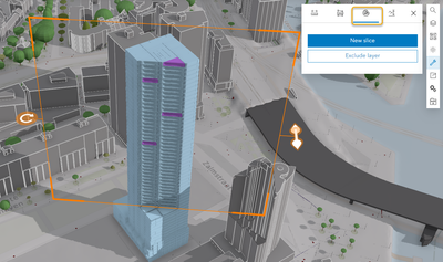

I wonder if there is a way to make a SECTION BOX like in REVIT where you can create a section in the model in 4 directions and isolate a certain item. In addition, I wanted to know if there is a way to display a filter in the form of a tree, like group layer that you can open and see where the object belongs.

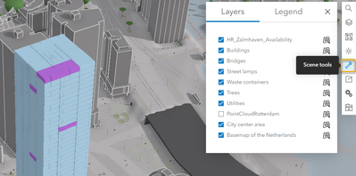

For  the first question you could use the Scene tools (see graph)
the second question currently you cannot do that, but you could create filters using this workflow.
https://www.esri.com/arcgis-blog/products/arcgis-pro/3d-gis/leverage-the-filter-capabilities-on-your...
