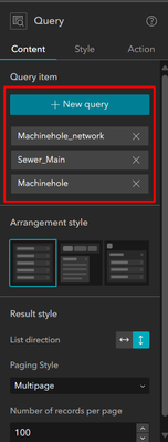

Hi,
Is it possible to have a dynamic data in query widget.
I have multiple feature layers in a map and I want to create a query widget in which I as a user can select the layer dynamically in query. For example, say I have 3 layers in a map named Road, Sewer and Transportation. All these layers have two columns which are common (say Area, Road Number). Now I want to create a query such that the based on the Area and Road number I want to get the corresponding details from the above 3 layers based on which layer is selected in the query (That for each case there should be flexibility in changing the data source).
Is it possible to do so and if yes can anyone suggest how to go about it?
Thanks
Remya_Ravikumar
We can resolve the issue by grouping queries in the same query widget.
Remya_Ravikumar
