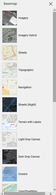

Hi @DavidMartinez ,
is there anything to keep in mind regarding basemaps when using the Developer Edition of Experience Builder? I created an experience, but I do not get the basemaps of my organisation but a list of ESRI basemaps (see below):
Thanks,
Martin

Another option if you're using the developer edition is you could import the Basemap toggle widget into a custom widget to add the toggle to switch between the two base maps.
