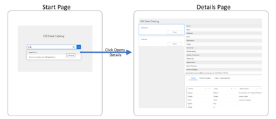

Hello!
we are currently using ArcGIS Enterprise 11.1... and I have a question about the search widget.

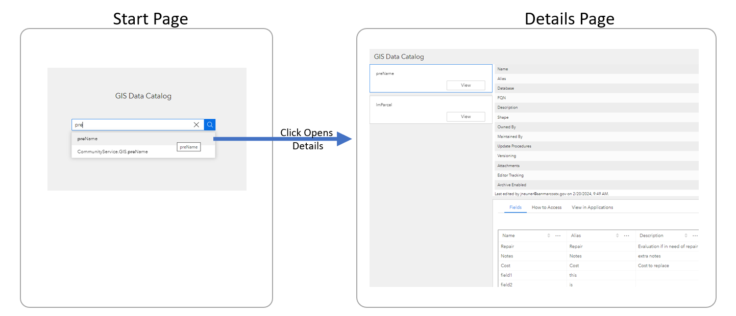

Here's the ideal workflow...
But what's happening is that when the user is taken to the details page, the item they searched for is not selected.
It seems like this should work (based on doc reading and another post (https://community.esri.com/t5/arcgis-experience-builder-questions/experience-builder-search-widget-h...), but it's not.
I'm hopeful there's just one thing I've missed in the configuration of all this that the community will know right away... *fingers crossed*
Thanks for any ideas out there!

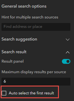

Hi @jessneuner ,
You are clicking on a suggestion, not a result. One workaround I can think of is to check the "Auto select the first result" option. Let me know if it works for you.
