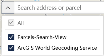

Using the new Experience Builder within our Enterprise/Portal for the first time. I have been searching for an answer to my Search widget within Exp Builder using only one of my locator utilities. I can't seem to find a setting for the Search widget to tell it to only use ThisLocatorService. Instead, when they type an address, it show the list for all of our locator services. Thank you for any assistance you can provide.
JonathanLee
Hi @GeorgeBrown1, if I understand correctly, you only want one search source to be used in the search widget. To do this, you would remove any other search sources in the widget configuration aside from the ThisLocatorService.
Below is a search widget with two configured search sources:
If I only wanted the first search source to be used, I'd remove the second one from the widget configuration.
