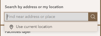

I have created an Experience Builder Developer application and configured a Search widget with the Use current location option enabled. It does basically the same thing as the Locate tool in the map and if you have an Action configured can zoom to your location on the map. It can also be used with other widgets such as the Near Me widget by allowing users to automatically search for features a given distance from their location without having to type an address.
The problem I am having is that when a user clicks the Use current location button the first time nothing happens.

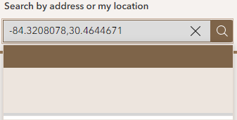

As you can see, the input element is populated with a set of coordinates, but no address shows up in the dropdown menu and there is no zoom action.
If I clear the input and try again, it works as expected.

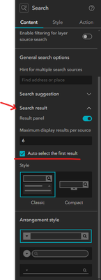

Do you have this Auto Select The First Result option turned on? It's in the Search Result dropdown in the Search Content Panel.
GIS Developer
City of Arlington, Texas
FranklinAlexander
I didn't have that option turned on and it zooms to my location now, but I still have an issue, however, with no results being displayed in the dropdown menu. I should be seeing an address instead of just coordinates, so something is still amiss.
