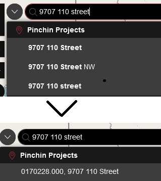

I see this behaviour as well. The map/data is the same, just one is WAB and one is EB.
In EB, I type the identifier and press "Enter". Then I get a list. Then I click on a list item... and then get another list. I then make another selection and finally go to the item.
WAB seems to skip this first step:
Honestly, I don't terribly mind this. But it is a big change to the search feature that I am sure users will comment on.

The first list shows search suggestions, while the second list displays the search results. The suggestion list should automatically appear as you type at least 3 letters into the search box.
I was unable to reproduce your issue in version 1.13. However, version 1.14 includes a related fix for the search results panel, so pressing the Enter key will now display the search results. Can you test version 1.14 and see if your issue is solved?

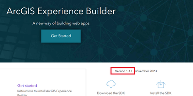

abureaux
MVP Frequent Contributor
I don't see 1.14 as an option yet:
