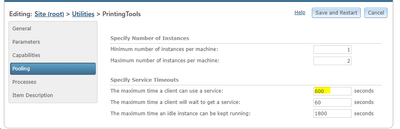

Grant-S-Carroll
Hi there, the print runs on your ArcGiS Server as you have indicated.
This is most likely where the time out is occuring. The default setting for custom GP tools is 600 sec, which is 10 minutes. I would check these settings in the first instance.

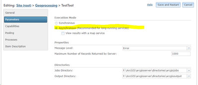

Are you running the service as synchronus or asynchronus? It may pay to change the service type to async if your are experiencing timeout issues, this will then stop the browser blocking the UI. Which could be another reason you are receiving timeouts.

Grant-S-Carroll
I would then check if the service is running Async or synchrononus. If its running synchronously, then I would switch it to async.
If you run the service in sync mode, then the widget will be sitting waiting for a response, it will time out because its a bad user experience to block the UI while waiting for a service to load or return. If you run the service async, then the widget should start polling for updates and then return the print when its finished.
