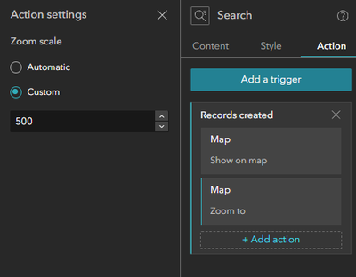

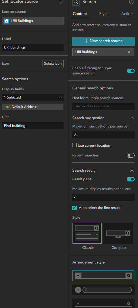

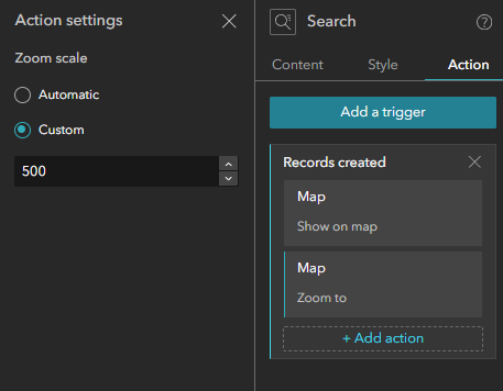

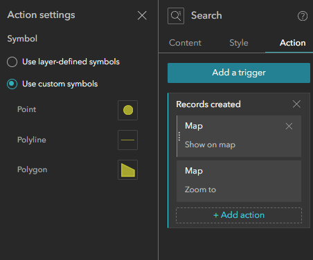

I am using the search widget with a locator source and want the map to zoom to the search result.
I set up the "Records created" trigger and the "show on map" and "zoom to" actions (see screencaps).
The show on map action is working (yellow dot appearing on the feature), but the zoom to action is not working. It seems like this is a common problem. Any suggestions?
mshanaghan_1-1729697807235.pngmshanaghan_1-1729697807235.pngmshanaghan_2-1729697821705.pngmshanaghan_2-1729697821705.png

mshanaghan
Thank you for the suggestion. I tried adding all three actions and changing around their order. It seems only the "show on map" action works.
