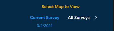

Hi,
I am new to Experience Builder and would like the current local date to appear in a text box. The idea is the map displays current survey day results for surveys and then another page displays all surveys, so the '3/2/2021' would update dynamically each day.
Is there a way to accomplish this? I'm not seeing an option since its not directly linked to selected data.
Thanks in advance,
Kathy

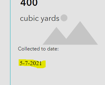

SolanaFoo2
Hey David,
I'm unable to get the font to stay in Avenir Next:
I switched it to black but besides that haven't changed anything else.
Thanks!
