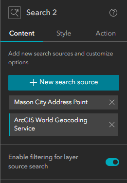

How can I remove the Geocoder from the Search dropdown? I can confirm that it is not in the Utility service:

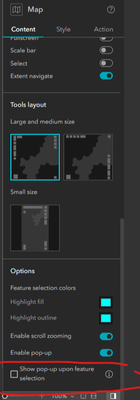

ChenChen4
Thanks my friend. I was using the EXB developer edition v.1.14 to build the web app and I have checked the "show pop-up upon feature selection" option:
Users don't like the appearance of the pop-up window and they are wondering if the pop-up windows can be smaller, but I don't believe it's customizable.

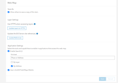

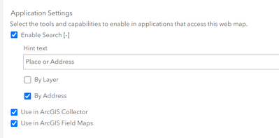

TonghuiMing
@ChenChen4 For the geocoder configuration of the map search tool, try going into the web map AGOL item page settings, and you may find something there:
ChenChen4
Thanks @TonghuiMing
I checked the Web Map settings and the "Enable Search" option is checked:

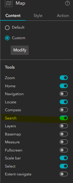

ChenChen4
Thanks my friend, but I'm not looking for feature layer popups. I need to a pop-up window for Geocode results from the Search Widget.  The workaround is to turn on the Search tool within the Map Widget and remove the Search Widget.  The Search tool provides the popup for any Geocoded results.
