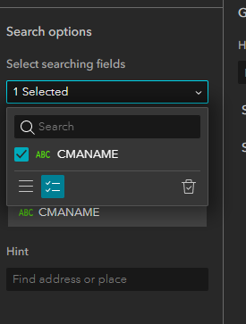

So, in my app, I'm using two sources for searching one which uses layer sources and another uses geocoding. The geocoding works properly. However, for the layer source, I'm searching by the CMANAME. When I type either Toronto/Victoria, it doesn't properly pan/zoom to it. Sometimes the CMANAME (Toronto/Victoria) won't even appear after I type. Can someone tell me why it properly doesnt pan/zoom to the extent and why the name doesnt appear when i type it in
 Screenshot for Panning/Zooming. The Average Home Values is the layer being used by the map
Search setting for the layer source

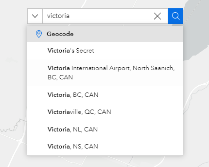

When I type Victoria, only the Geocode source shows up, it should also show the other layer source name

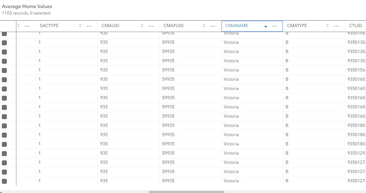

Average Home Values dataset
I can't reproduce this issue, can you provide a sample app?
