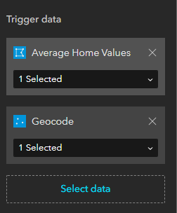

So, in my app, I'm using two sources for searching one which uses layer sources and another uses geocoding. The geocoding works properly. However, for the layer source, I'm searching by the CMANAME. When I type either Toronto/Victoria, it doesn't properly pan/zoom to it. Sometimes the CMANAME (Toronto/Victoria) won't even appear after I type. Can someone tell me why it properly doesnt pan/zoom to the extent and why the name doesnt appear when i type it in
 Screenshot for Panning/Zooming. The Average Home Values is the layer being used by the map

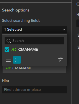

Search setting for the layer source
When I type Victoria, only the Geocode source shows up, it should also show the other layer source name

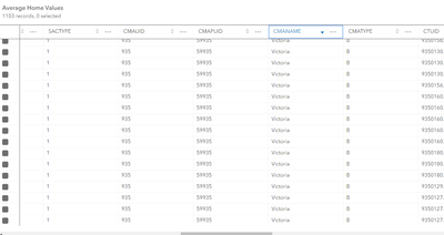

Average Home Values dataset

Hi @Mento ,
This is a known bug, that the map does not zoom to the correct extent when there are multiple trigger data.
I can't reproduce this issue, can you provide a sample app?

Mento
@ShengdiZhang so I can only use one trigger action in order for it to work properly? Also, could you provide me ur email so I can add you to the group and share it
ShengdiZhang
This is because there are two trigger data. Currently, zoom to and pan to actions only work correctly when only one trigger data exists.
